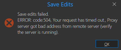

I have a hosted feature layer with 2953 features. I want to do some calculations with field calculator, so I loaded the layer into ArcGIS Pro. However, whenever I want to save my edits, I get the following error:
Save edits failed. ERROR: code:504, Your request has timed outed., Proxy server got bad address from remote server (verify the server is running).
I found out that, if I edit a maximum of 300 features per time, this error does not occur.
Any idea how I can fix this issue?
