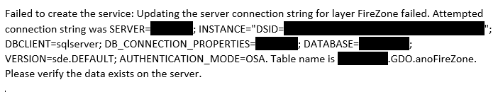

I am using ArcGIS Pro 3.0.3 to publish/overwrite an annotation Map Service on our stand-alone ArcGIS Server running 10.9.1 with all the current patches.  This morning I created a new annotation layer, added it to the map I publish from, and attempted to overwrite the existing Map Service to the ArcGIS Server.  At the end of the publishing process, I received an error message that the overwrite failed to publish the map service.  Upon looking at the log, the following error message was found: "StatusMessage: ERROR 001487: Failed to update the published service with the server-side data location. Please see the server's log for more details."
The server logs indicated the new Annotation failed to update the connection string for the new annotation layer.
