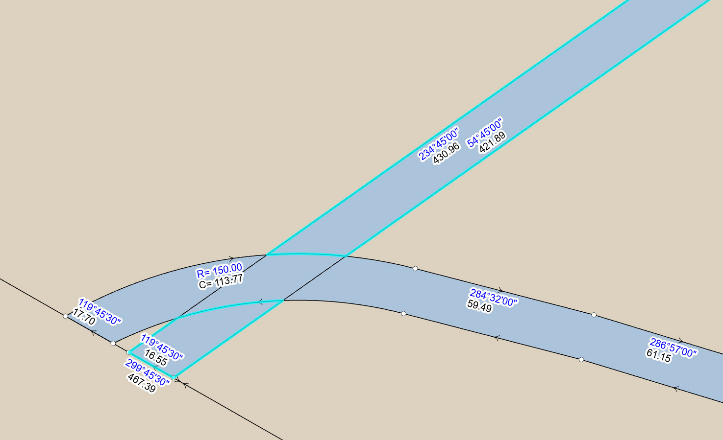

I am using ArcGIS Pro 3.1.3 with a prototype Parcel Fabric Version 5, currently experimenting and practicing in a local drive. I am trying to traverse two intersecting encumbrances from a survey and running into some issues. Typically, I construct as lines, generate seeds, and build. This has always worked great, retaining and displaying the entered COGO without issue. However, in this instance of intersecting encumbrances, when I construct as lines the seeds are generated for every segment, creating erroneous overlaps and ends. See below.

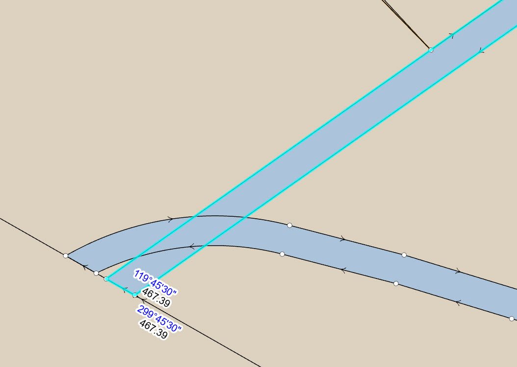

When I construct as lines and build one encumbrance at a time, the first one will build fine but the overlapping one is split into two separate segments, omitting the intersecting segment from the second built encumbrance. See below.
When I construct as polygons, the two intersecting polygons build correctly however the entered COGO is not retained. See below.
I ran the ‘Update COGO’ tool on the encumbrances built as polygons however the output measurements are slightly off from the metes and bounds that were entered from the survey.
