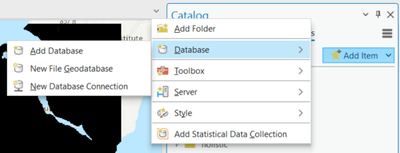

You are correct that new database connections cannot currently be created in folders outside the project folder. But note that you can create the connection file (either as a Favorite > Add Item>
or from the Databases node under the Project tab:
KoryKramer_1-1702734738209.png)
and then you should be able to move that connection file to any other folder.
Please see this idea to add the option to other context menus https://community.esri.com/t5/arcgis-pro-ideas/add-quot-add-new-database-connection-quot-to-new/idi-... Add your support by giving it kudos.
