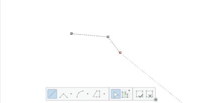

It also appears on the editing toolbar:
Just curious, why are you needing to finish a sketch with the right mouse button?

Thanks for the additional info. Regarding your statement on deleting and moving a vertex being time consuming: maybe you know this already, but if the sketch is still active, you can enter into vertex editing mode by hovering over a vertex (or segment) until the cursor changes from sketch mode to vertex editing mode, and then move the vertex where you wanted to place it, or right click to delete it from the context menu:

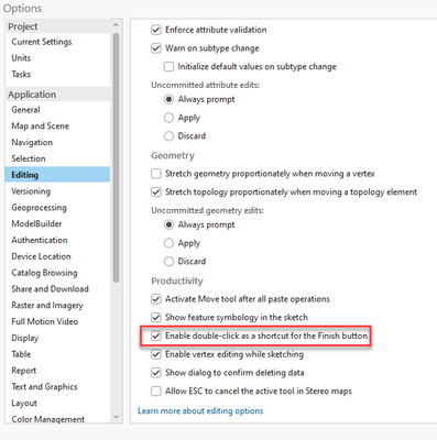

Another FYI, this feature can be turned off from the editing toolbar:
As for a reason why right-click isn't the default for finishing a sketch, I assume because the context menu has a lot of functionality while sketching.
Perhaps turning off double-click to finish a sketch, and strictly using F2 or the toolbar (or map esri_editing_FinishSketch to another key using Accelerator) is an alternative solution to unwanted vertices.
