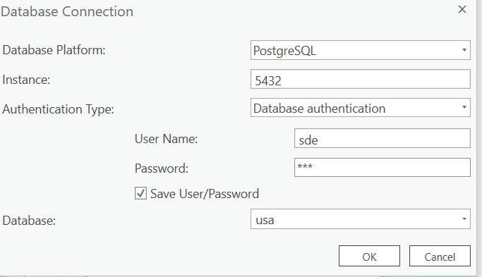

I am new to the Postgresql and quite familiar with ArcGIS Pro. I create a database usa in pgadmin 4 (13.6 version) and import the data into usa database. Then I created login role sde and password in pgadmin and sde schema in usa. Then I went to ArcGIS Pro (2.9) Catalog and right click on the Databases and click new Database connection and configure the connection below. It is successfully to establish the connection. See below.

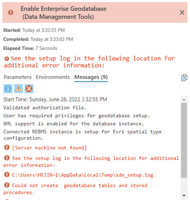

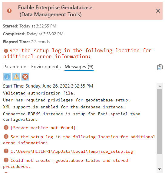

Then I need to enable the enterprise geodatabse, but get an error message below.
It seems that there are multiple problems in there. Anyone who can help me to figure out the problem and how to solve these issues? Your help will be highly appreciated.

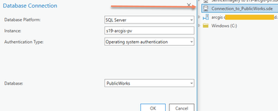

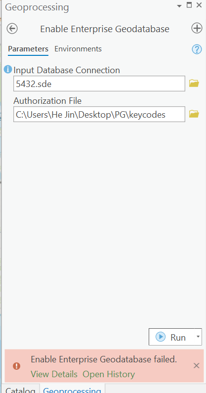

I haven't used the Enable tool, normally would just run the Create Enterprise GDB tool.
But, when you made the database connection, did you actually name it 5432.sde?
I see that is the instance/server name, but the enable tool is looking for the connection file, which would/could be named something different:
(instance name won't work, need to use the name that is in the catalog pane)

I do not name my connection files (.sde) with the port number. I usually use the following naming convention: <username>@<dbname>_<RDBMS>
I would set it up just like your screenshot above except that it is connecting to PostgreSQL.

You are correct. The port number does not work properly. The localhost worked fine.
HeJin
I used the "create enterprise geodatabase" once and were able to connect the exsiting database in pgadmin. I also changed the instance to localhost and used a new computer. It worked without any errors. Thank you so much for help.
