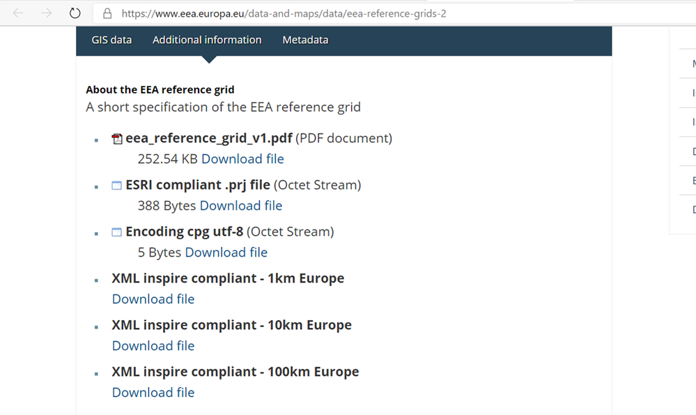

For some reason they've not attached a .prj file in with the shapefile (this specifies the projection info).
You can either use the 'define projection' tool or get the .prj file and readme guide from the site on the 'additional information' tab.  GRID.png

That is brilliant, David! And so simple! Thanks so much. I am obviously still pretty new to this whole mapping stuff, but love using ArcGIS and playing around with it for any project I can find. This 'define projection' is a really handy tool!!! Thanks again!
