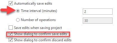

ISMAELAGUILAR
Hi, thanks for the assistance.
attached is the setting i have for both session.
two minutes of intervals is the adeciduate number to make the edits reflect on both sessions?
