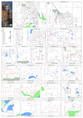

I'm making a county map, and the back has several detailed views for all the subdivisions and villages. Is there a way to make changes for one map happen to all the others so I don't have to make little changes one at a time? They all use the same feature layers.
JonM32
@ThomasGoodridge Yes, you can.
If all of the inset maps are using the same map, then changes made to labeling/symbology/etc will show up in each one automatically.
