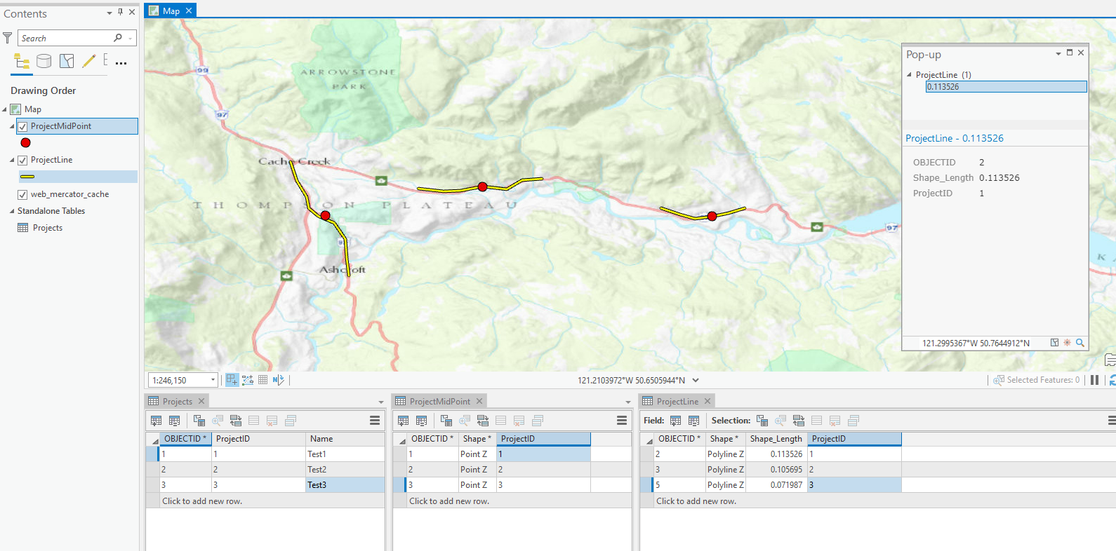

I have a main table with ProjectID and Name. ProjectID is the foreign key in 2 (or more) 'geometry' tables as a Project can have points AND lines associated with it. The screenshot is from ArcPro. The tables are shown in the screenshot as well.
What I'd like is to have these show up as a unified dataset (from user's perspective) in ArcGIS Online webmaps (could be done through a temporary join?). When a feature (point or line) is clicked, it brings up Project Name, and a user can edit Name (in the Projects table) corresponding with the selected feature. I'm not familiar with how to do this in ArcPro/ArcGIS Online.

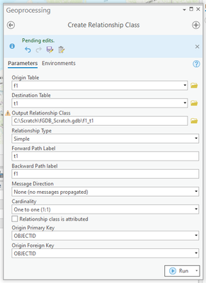

You are left with relationship classes. Here is an example of setting up a relationship, f1 would be for example your point layer and t1 is your projects names table
Repeat for your polyline layer.

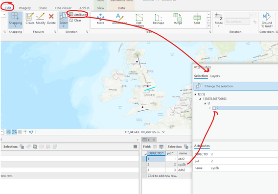

Then when you select a point and you are on the Edit tab and have opened the attributes panel then by expanding out your selected feature you see your related table and editing the name there means if you select a polyline you will see your updated project name.
