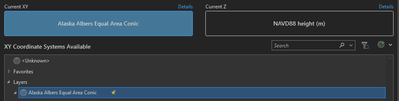

Every time I update some Z values (frequently, unfortunately), I have to change the units from feet to meters.
The vertical units of the layer in question are meters.
I have:
-changed the Map Properties/Coordinate System/Current Z to a height systems in meters

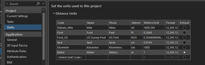

-set the Project/Options/Units/Distance Units default as meters.
Even after saving, closing, and re-opening, I still have to change the "ft" to "m", otherwise my values will be off by a factor of 0.3048.

@Kevin_Andras What is your coordinate reference system and default linear units? In map views, ArcGIS Pro sets the elevation units to the linear units defined by the map's vertical coordinate system, if it exists. If a vertical coordinate system is not assigned, it is set to the linear units defined by the map's x,y coordinate system.

Hi, the map's coordinate system (xy and z) are in meters.  The ArcGIS default linear units are meters .
