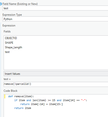

That is my bad I should have attached a screenshot, it should look something like this:
Cody

If these are incorrect, would it be possible to just fix them? If the - is always at the 15th slot, you could use a calculate field function to fix this:
def remove(item):
    if item and len(item) >= 15 and item[14] == "-":
        return item[:14] + item[15:]
    return item
I would test this on a small subset of data to ensure this does what you're expecting!
Cody

I tried to run the expression but I got an error message (though the expression is valid):
CodyPatterson
MVP Regular Contributor
Hey @dsinha
Cody
dsinha
Thanks so much for sending the screenshot @CodyPatterson. Worked like a charm!
