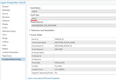

Hi,
We have APR configured in our Enterprise SDE.  I am trying to perform dynamic segmentation based on Line Events as well as Point Events like VALVE and **bleep**. The tool only lists Line Event irrespective of Networks selection (Engineering STA or Continuous MEA). I verified the point feature has attributes DERIVED_MEASURE and DERIVED_NETWORK_ID. The point features are also part of Location Referencing.  Kindly advise whether the Dynamic Segmentation tool doesn't work on point events or its a configuration issue? I am using ArcGIS Pro 3.3.1. Below are snapshot of tool and point features.
