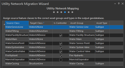

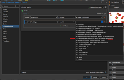

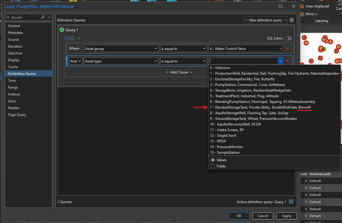

We are in the process of migrating our data from GN to the UN.  We've used the Utility Migration Wizard in ArcGIS Pro v3.5 to migrate our data.  After migrating, I'm going through and republishing web services.  However I've ran across a problem when doing so.  In our WaterUN.Device feature class, we have an asset group called Water Control Valve with an asset type of "BLowOff".  When I add that feature class to arcgis pro, then try to definition query to only show blowoffs, I'm not getting blowoff as a choice.  I'm getting what I would call, a grouping that consists of several feature types.  In the image below, you can see 1 though 11 are all "groupings" when they should be an individual asset type.  All the other features migrated to our WaterUN.Device layer without issue.  This was the only feature class that gave us a problem after migration.  Any ideas on what I'm doing wrong or how I can fix this?

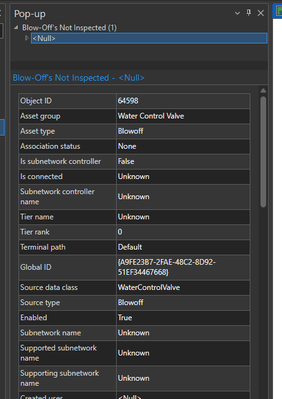

No problem.  This first image is the popup of when I select a blowoff.

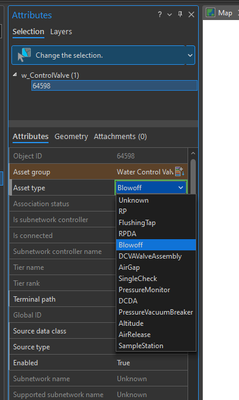

This image shows when I'm editing, I have the option to choose whichever asset type I want.
