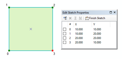

It would look like this:
Ideally, it would use the zero-based numbering system — to be consistent with the vertex numbers in the Sketch window.

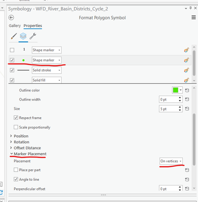

I created a new shape layer for the polygon symbology, a green dot, and made sure marker placement was on vertices:

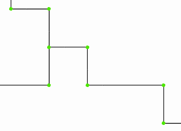

This creates this affect:

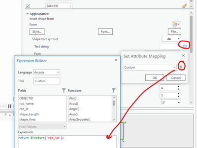

I added another shape marker but set it to TEXT form, turned on Allow symbol property connection and as way of example set the custom text to be an attribute

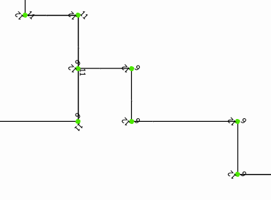

And you get this affect (its a location where 3 adjacent polygons come together):
I can't work out how to assign a changing piece of text (vertex order number) to each unique green dot, it appears to be a whole feature affect.
