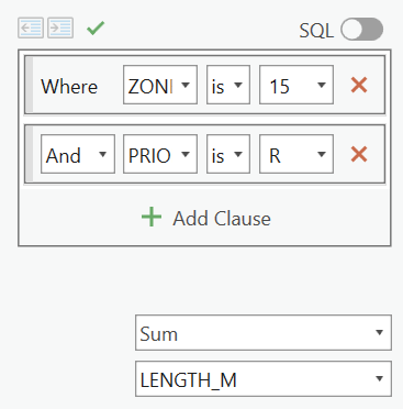

Looking for some help with a dynamic text query that should display the length of a route based on its priority. I'm not understanding why the number in my layout isn't matching what can be seen in the Statistics and Data Engineering panes:
I believe the dynamic text is displaying the sum of priorities R (9,737) and W (825)
