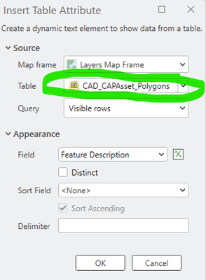

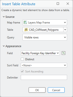

Original Layout with Dynamic Text displayed correctly.
New Layout with dynamic text not displaying.

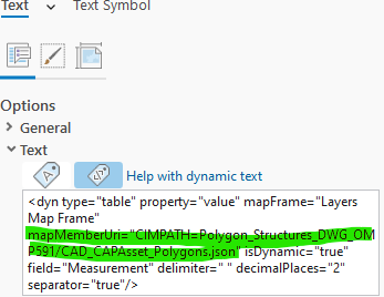

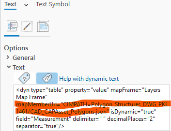

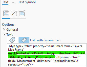

The mapMemberURI is still calling to the original layout/map when it should be

These are not tied to a map series. The layout was derived from a Map Series initially but there were some maps in the series that did not fit so they have their own layout. That was what I initially thought was the issue but after testing it with layouts that are not in a series, it confirmed the issue that the Dynamic Text is calling to the incorrect mapMemberUri.  The other issue being that even if you copy it to the new layout and change the table that it is referencing, it is still calling to the incorrect mapMemberUri. It seems to be getting hung up on the "parent" layout.

I believe this is a bug.  Here is the bug number that you use to track the issue - BUG-000178730.
To work around this
  1. Open the Insert Table
  2. Set the Table to None.
  3. Click OK.
  4. Go back into the dialog and reset the Table.
  5. Click OK.
Or you can manually update the CIMPATH to the correct map name in the Element Pane “Plain text view”.
Setting the Map Frame to “None” does not reset the element. You must “reset” the table (layer) link.

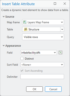

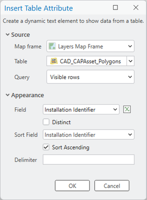

Thanks for the response when I attempt to do the workflow described I run into a different issue. These are the parameters I have set in the dynamic text options.

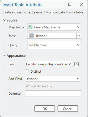

I set table to <None> as shown below and push OK.
I get the following results when I open the window again. Instead of the table being <None> it has changed to a completely different Table (Structure) and Field(infadsfacilityidfk) in this case. If I change the Table to the desired table, this results in the Field changing to something else entirely.
Changing the CIMPATH is something else I was doing but doing this 5 times on 30 maps is time consuming.
