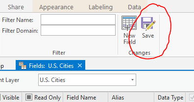

Tom, I applied the formatting of 0 decimals and checked the thousands separators box for the field but nothing happens in the attribute table.
TomBole
Martie,
Once you save the changes in the Fields View the changes should automatically be picked up by the attribute table, table frame (on the layout) or dynamic text.
If things are not working as expected then it is quite possible you have run into a bug.  Currently, I'm not aware of any issue where number formatting is applied (saved) to a layer and this change is not reflected in the attribute table, table frame (on the layout) or with dynamic text.

MartieClemons

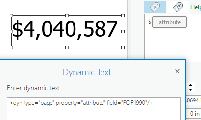

Thanks (embarrassed).  I keep forgetting that I need to save because I never started editing (ArcMap habits)! Anyway, the values look great in the table but when I reference the field in a dynamic text item in my map series, the formatting gets lost.  Here's my dynamic text: $ <dyn type="page" property="attribute" field="MockupTablev3_TOTAL_COST"/>
TomBole
Martie,
I don't know of any reasons why a dynamic text would ignore number formatting.  In my quick test everything looked fine.  Could be something specific with your data/layer/map/layout.
You might try using the Value dynamic text element found under Table Attribute and see if that works.
If you can't get this to work I would treat this issue as a bug and take it to technical support. They can be contacted at https://support.esri.com/en/contact-tech-support.
