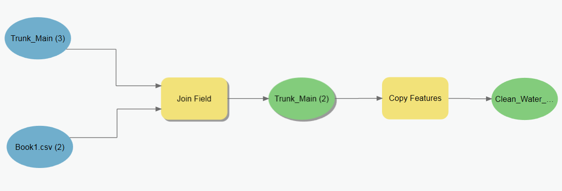

Try a similar model as above--make sure to add your output to display.

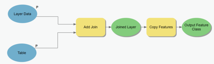

Hi Douglas,
created a model as below -
while running am getting the below error - any guess? please !!
by Anonymous User
Not applicable
Ian, it looks like it is the path you are trying to save to is causing the problem. Try to save it in an accessible folder or even better would be a file gdb.
