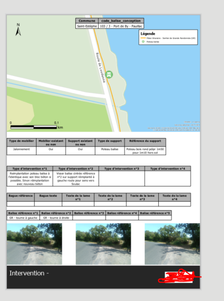

Hi, I'am using Field Maps to collectect data and pictures. I've set-up a map series layout and would like to add for each point the photo (or photos) taken of this specific point with Field Maps.
I cannot manage to do so. Does anyone could help?

can you clarify? are you looking to show the picture in the layout? or just show the photo points?
arthurV
I would like to show multiple pictures (attachement from Field Maps) on a map serie layout Captureaaaaa.PNGCaptureaaaaa.PNG
I managed to add 3 different picture frame on the layout, but now I am stuck to indicate I want each frame to show a different picture (in my map serie, each point have a different number of pictures, some have only one, other 2 or 3).
