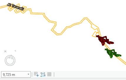

Screenshot 1) Why are the layers shifted? No coordinate translation should have occurred in the above mentioned geoprocesses. One layer should be sitting on top of the other.
Screenshot 2) Zoom in 700m and the green layer starts to disintegrate and the red is stable. Why? Why don't both layers behave the same?
Zoom in ~700m and the green layer starts to disintegrate and the red is stable. Why?

during the process from Longitude/latitude to featureclass, whas the data defined as a GCS WGS84 ie a geographic coordinate system.  Undefined data can behave strangely especially if you are working with web-based web Mercator data.
JOHNDONALDSON4
Deactivated User
Dan,
I've double checked that. The CS is the same for the input & the output = GCS_WGS_1984.
After cleaning up & re-running several times the dubious behavior is still very evident:
  • output layer is shifted to the south.
  • it disintegrates when zooming in
  • reintegrates when zooming out.
Feature to Feature geoprocessing: Please note "Output CS"
DanPatterson_Retired
MVP Emeritus
You might have to show your csv with the coordinates.
recently coordinates that were converted from Degrees Decimal minutes incorrectly caused a shift... so I am leary of anything shifty these days
