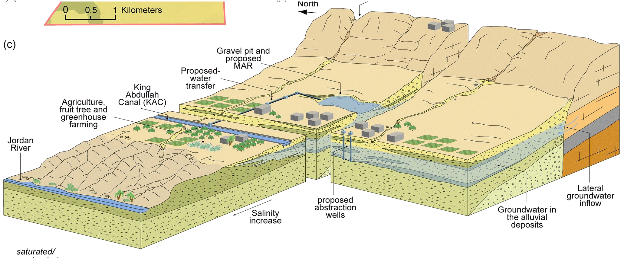

Hello all,
How can I draw like this figure using ArcGis Pro2.9? For each block, I have multiple layers with different thicknesses and different elevations (top and bottom). Illustrations on top (trees, buildings, etc...) are not very important.
Thank you,
Salah

Would this posting containing videos created by John Nelson help you get started? It's posted in the ArcGIS Pro Videos category and explains how to make a 3-D diorama. https://community.esri.com/t5/arcgis-pro-videos/how-to-make-a-micro-world-3d-diorama-thing-in-pro/m-...

Hi Linda
Thank you for the reply. I watched the videos, however they do not satisfy my needs.
Best,
Salah

yes, i'm curious about this, too. in my examples i just add a dirt-like graphic to the sides, not real data like this example. i did wonder if voxels would be a useful thing to research for this. but i am uninitiated with voxels. anyone out there have ideas for how to make data-driven depth profiles for cutaway illustrations?
