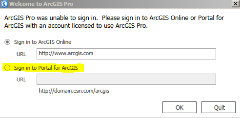

At Pre-release, when logging in, I see an option to use Portal to license ArcGIS Pro:
However, when I put in our Portal URL, I get the following error:
Obviously, we need to load Pro licenses into Portal, but I can't seem to find documentation on how to do that or even where we get licenses.  Can someone point me in the right direction?

Hi Joshua,
This is just a timing thing. You'll need a 10.3 release of Portal in order to use if for licensing ArcGIS Pro. You got the Pre-release of Pro a little earlier than everyone else since you're in the beta program.
