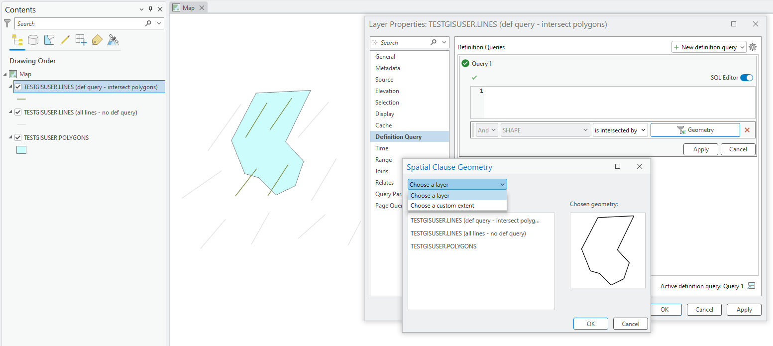

Do spatial definition queries use SQL or ArcObjects code to perform the query operation? (ArcGIS Pro 3.5)
Assorted thoughts:
My best guess is ArcObjects is used, not SQL, to perform the query. I say that because I don't see any SQL when I switch to SQL Editor mode (Pro 3.5 Home Use; Oracle 18c Express database; SDO_Geometry; non-GDB; ).

Filter features with definition queries
Definition queries are composed of one or more clauses. There are two types of clauses: attribute clauses and spatial clauses. All clauses are written in SQL syntax and constructed using the query builder.
I'm wondering if "All clauses are written in SQL syntax" is misleading, and doesn't apply to spatial definition queries.
TanuHoque
@Bud
Thanks for pointing that out. We will work on updating our help doc to make it clear. Attribute clauses are written in SQL syntax. Spatial clauses are as you suspected complicated!

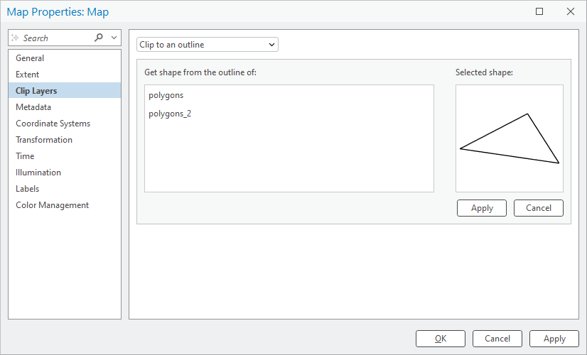

Maybe the spatial definition query functionality was copied from map clip layers:
Credit for this observation goes to @AlfredBaldenweck in Spatial Definition Query — Highlight chosen layer
TanuHoque
you folks are right that we tried to reuse the same user experience/UI from Clip Layers functionality. And that is where the similarity ends, the implementation is completely different.
