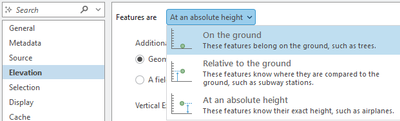

@FriederDaeublin Try moving the Layer "Abfahrt_sections1_z" under 2d Layers.
Also select the appropriate option at Layer Properties > Elevation > "Relative/On the ground". Try different options here.

trying to move the "Abfahrt_sections1_z" Layer to "2d-Layers" does not change anything - BUT:
Moving it back to "3d-Layers" will show the Z-feature wit its origin z-values - hobering above my TIN - like it does in ArcScene.
But this seems to be a workaround. I do not understand why it behaves like it does.
