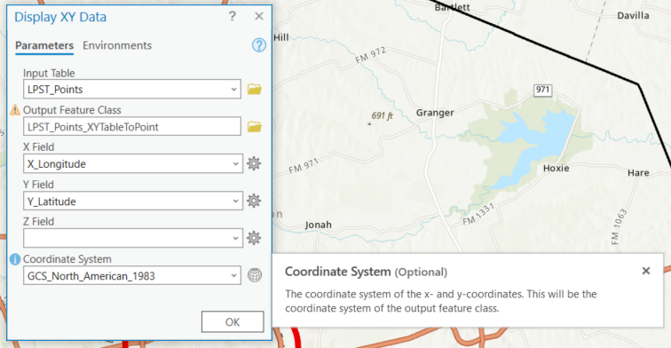

Hello, and please see screenshot below of the Display XY Data tool for reference.
The Coordinate System input for this tool concerns me in several ways:
1. Am I correct that the default is the Map's coordinate system?
2. Regardless, it is suggesting that whatever this is set to will be the Output coordinate system.
But, my understanding has always been that this needs to be "defined" because it is a Standalone table and is "unknown".
With that, it is the Input coordinate system that is defined here; and the Output coordinate system will be that same thing.
With that, how is this "Optional"?
Thanks to anyone who may be able to clarify this

In ArcGIS Pro 3.1, the coordinate system in the Display XY Data geoprocessing tool is the coordinate system of the XY data in the table not the Map View in ArcGIS Pro.  You're correct that non-spatial tables do not have a coordinate system but the columns/data in the table is referencing what the XY data coordinate system is.  For example, if you see -105.5 and 37.5 values in the table, it's likely WGS 1984.  If you know the metadata of the table, then maybe it's the GCS_North_America_1983 coordinate system you selected in the GP tool.  I don't have an example of the optional parameter value sadly.

Thanks for responding, Robert, but I'm not sure my questions are answered. The screenshot I provided is just an example, not to be taken literally -- I just included it for general reference purposes. ...If you don't mind, let me try again, and I'll try to be more direct to the point:
1. Why does the Coordinate System "information hypertext" NOT indicate that this is to "define the Input Table coordinates?" The way it's worded almost makes you think you can choose ANY coordinate system here for the output.
2. And, how can this input even be considered "Optional?" ...What happens if you leave it blank ...are you saying that it will just go with Geographic, WGS 84? If so, wow, that seems like a big guess to me.

I can't really speak on ESRI's behalf, but i think it's probably more like a default value. More often then not, you have Lat/Long in your tables using Display XY Data. I think the assumption is, you would project your data to your spatial reference after the data is displayed. At least that's what I do. I accept the default value and project the data to my local spatial reference.

Thanks, but you CANNOT just do what I think you might be saying. ...For instance, accepting the default GCS WGS 84 coordinate system, when your Input coordinates are really PCS State Plane NAD 83 will have your points drawn someplace very far away from where they are supposed to be. Re-projecting will not do you any good at that point. However, you might be able to still "define" the projection at that point to correct it. But, of course, that's what you should've done in the first place.
I'm only questioning the language in the "information hypertext" that I believe is misleading. And, I think you're interpretation now confirms that. I also don't really care for the term "Optional", because it's not, from my perspective. ...I suppose it's optional to accept the default or not, so maybe that's what they mean. But, I think that is also misleading.

I cannot speak for the ArcGIS Pro development team and why the information hypertext is written the way it is as I work in Training Services.  If you click on the ? mark top right of the GP tool it does open the tool help and for the Coordinate System (optional) it says "The coordinate system of the x- and y-coordinates.  This will be teh coordinate system of the output coordinate system."  I did some digging and found that the tool can automatically detect the coordinate system of the input data (i.e. a spatial table).  If the input data contains the spatial reference information, the tool will use that information to determine the coordinate system.  If it can't find the spatial reference, then you can manually enter it.
