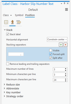

I found an answer that worked for me.  Enable 'Stack Label' and use a comma as the stacking separator.
