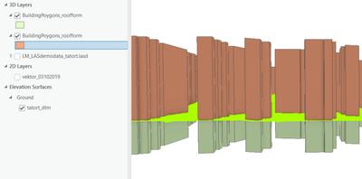

add the layer twice to the table of contents, use one for height and the other for depth
if that doesn't work make a copy and use the copy and the original for the above

Would it be enough to add the layer twice to your scene and extrude one based on the height and the other one based on the depth? I do not think it is possible to extrude one object in two directions at the same time.

Would it be possible to just do it in two different layers?

Thank you all for your time and responses. All good!
