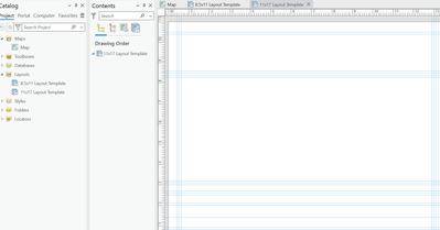

AAAAHHHH!  Just happened to me as well, running Pro 3.3.  Also happened to both my coworkers in the last month.  Its diabolical, since it doesnt matter how often you save, and most IT backups come at end of previous day.  So, lost a whole day of work and now contemplating moving back to ArcMAP
This is scary esri!
info: I first noticed a layout text element acting strange when I tried to move it around, so I saved/reopened annnd everythings gone. - Dont save once you notice something screwy, just close/reopen.
I only had two layouts open and in the project, only map was default 'Map' with one Imagery service layer, and they were templates loaded from a layout file, pretty sure these templates were originally loaded from old ArcMAP .mxds.  Data is on a local server.  Windows 11 23H2 22631.4317.  Intel Core i7-13700, 64G RAM.  Sophos Security
