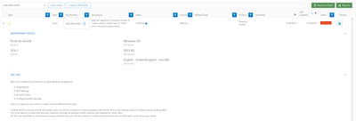

There is not one out of the box; you would need to either disable Utility Services or create a custom role to restrict access to it. You can ask your account manager to sign up for this enhancement that is requesting exactly this functionality within ArcGIS Enterprise.
ENH-000120963
