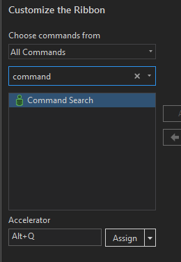

To answer your last question, they are. Sort of. Are they in an easy-to-find, intuitive spot? Maybe not!
You have to go into the Customize the Ribbon tab of Settings to find them. (No ArcMap experience here, so I've no idea how that compares.) And finding existing accelerators is even less clear. You have to know what the tool is, then search for it, and if it has an accelerator, maybe you'll see it.
If you can, that's also where you can either change the keyboard shortcut, or remove it entirely.
