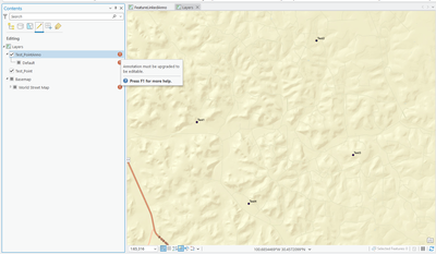

JMutunga
@DaveMartin1  Could you confirm if any error message appears on the annotation layer in Contents pane? I took this screenshot of an MXD I imported in ArcGIS Pro BEFORE running the Upgrade Dataset tool. If the tool runs successful, that message/badge should disappear and you should be able to select and edit the features with the Annotation editing tool.
It is always advisable to backup your data and understand all limitations before running the Upgrade Dataset geoprocessing tool.
