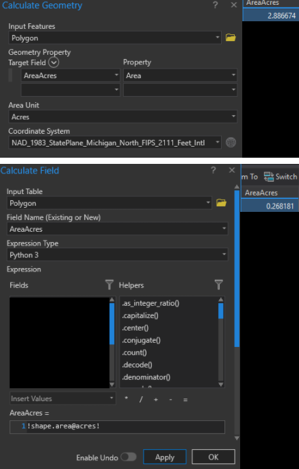

I am trying to calculate the area of a polygon in ArcGIS Pro and am getting a different value in Calculate Geometry in Pro:
ArcGIS Pro Calculate Geometry in Attribute Table: 2.89 acres
ArcGIS Pro Measure > Measure Features Ribbon Tool: 0.27 acres
ArcGIS Pro Field Calculate (!shape.area@acres!) in Attribute Table: 0.27 acres
ArcGIS Map Calculate Geometry in Attribute Table: 0.27 acres
The map and the layer is in "NAD 1983 StatePlane Michigan North FIPS 2111 (Intl Feet)".

Hi all, this same issue seems to have been discussed here:
https://community.esri.com/thread/257576-pro-260-geometry-calculation-error
Appears to be a bug and will be fixed in 2.6.1.

I wonder if it's related to calculating Area vs. Area (geodesic)?

Thanks, Katherine. Unfortunately not:

How was the polygon created? I had a similar problem that resulted after I used the Union tool on two separate layers. I put the output in the Coordinate System I wanted, but I didn't project the layers initially before using the Union tool, so that caused issues. Maybe "starting fresh" would help?
