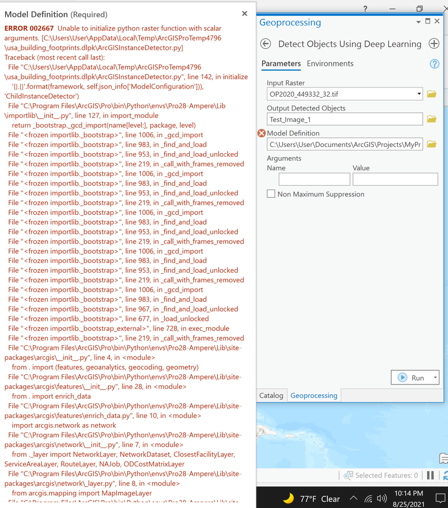

Hulseyj
Hi samaloysius4,
I successfully installed the new deep learning ampere preview in my new clone environment (thank you!). However, I am getting an error with the geoprocessing tool "Detect Objects Using Deep Learning', specifically with the Model Definition when I use the usa_building_footprints.dlpk. I tried a few other .dlpks from the Living Atlas and same error with the 3 or 4 that I tried.  Please see the message I am getting associated with the Model Definition (screenshot attached). Any ideas?Screenshot 2021-08-25 221523.png

Below is the full error report when I ran the model from the Python Window. The screenshot above cut off some of the error read-out.

samaloysius4
This looks like an install issue. would like to point to the comment for the Esri DL github page for the steps to install incase something was missed . https://github.com/Esri/deep-learning-frameworks/issues/17#issuecomment-905895867
Also as mentioned on the page , this is just a tech preview , so there may be workflows that may not work.
