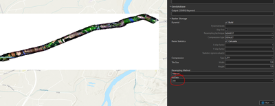

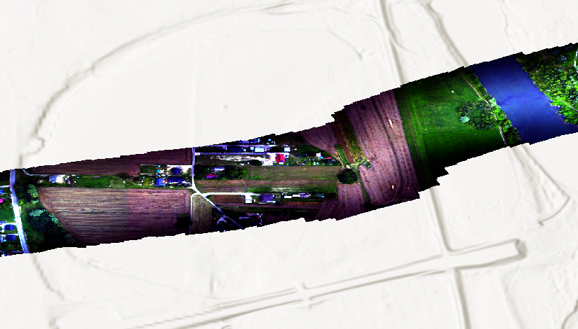

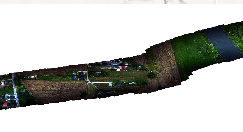

 Part of the script is supposed to mosaic the newly added raster datasets to a geodatabase. The original rasters have no background but after using the Mosaic to New Raster function, a white background is added. I know that this background can be masked out in the symbology pane but I would like to handle it using arcpy. Could you please suggest a solution?
Before mosaicing
After mosaicing

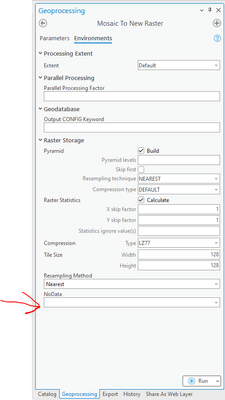

Hi Jakob, It looks like the tool is assigning a background value  to your mosaic. You could try checking the value of the white background, then setting your no data value to that value in the Environments pane of the Mosaic to New Raster tool, re-run and see if that helps.

JakubWabinski
Thanks for your answer. But the mosaic has 4  8-bit bands. What should I write there? 255 only or rather 255,255,255?
MichaelS
Just 255 should be sufficient.
-Enterprise Support Analyst
JakubWabinski
Still having the same issue. I tried with both: writing 255 and setting the parameter to 'maximum'. Any other ideas?
