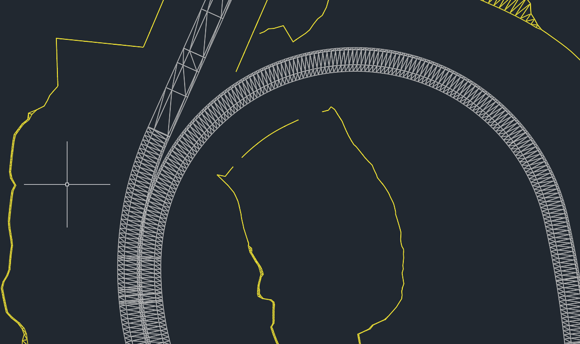

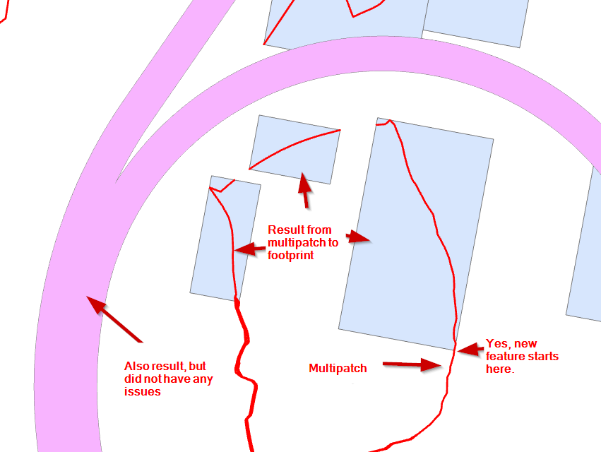

I've noticed that several times when i use the CAD to Geodatabase tool and get a multipatch feature it works quite well, utill i use the "Multipatch footprint" tool to create a 2D version of said multipatch feature.
What happens is that the tool sometimes create squares (extent areas?) around certain features, normally when they are really thin (See figure):
in cad file:
Possible Culprit:
It seems like the culprit is small/ vertical (?) poly-faces that bugs up in the tool. I have no other ideas.

As nobody replied, i had to fix it.
What causes the problem?:
thin/vertical elements in the multipatch dateset. When using multipatch footprint, the tool cant create a polygon with vertices on top of each other, and therefore creates a bounding box.
How to implement a fix
So the solution is to remove all squares, taking advantage that bounding-boxes always has the two first vertices share X coordinate and the second and third share Y-coordinate.
Note that you cant use the "group by" option for this to work.
