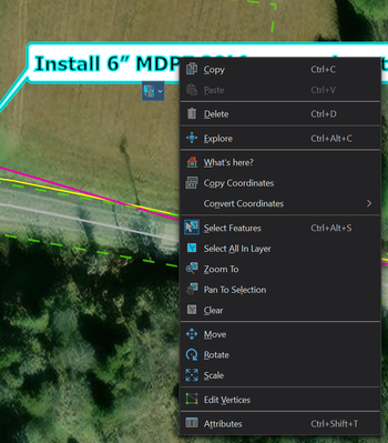

If the text is in a layout, you should be able to right-click the text in the contents pane and then choose the delete option.
If text is in a map you can select the text in the map itself using the select tool and then right-click and choose delete.

If the text was map annotation in ArcMap, it will be imported to a Map Graphics layer in the map. To select and then delete these text elements, use the Select tool on the Graphics ribbon.
