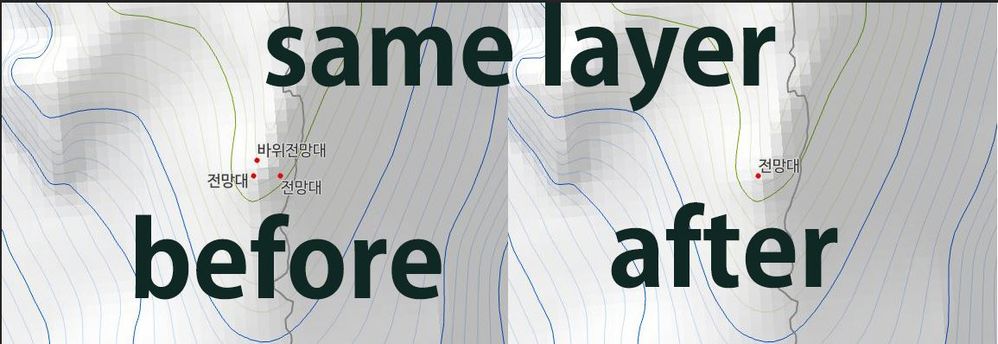

I'd like to save one close point on the same layer and delete the rest.
What's the best way?
DanPatterson
MVP Esteemed Contributor
same as before... use the Near tool, for the closest.  keep the closest and save it to a new featureclass.  You don't need to delete the rest.  When you save a file with a selection only the selected features are saved and the rest ignored
