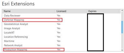

So, the licenses are available. Please Check for the toolboxes of Topographic Production tools and Defense tools.
Note: Some tools (Topographic Production) require additional extension like Spatial Analyst or Workflow Manager. Topographic Production toolbox licensing

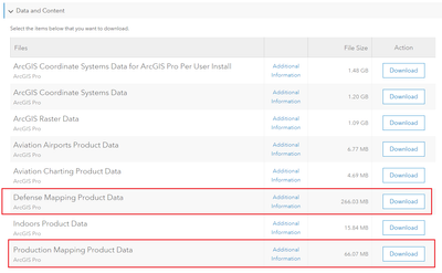

Additionally, you may download and install the Product Data files from My Esri.

I assume you don't see the licenses under Esri Extensions in ArcGIS Pro (Licensed: No).
If your licenses are Concurrent Use type, please ensure that you have authorized Defense Mapping and Production Mapping for ArcGIS Pro (not the ones for ArcGIS Desktop - ArcMap). Even though you choose ArcGIS Pro while authorizing, if the license keycodes are that of ArcGIS Desktop (ArcMap), the latter will get activated.
If you have difficulty finding the corresponding keycodes for ArcGIS Pro, please contact Esri Technical Support.

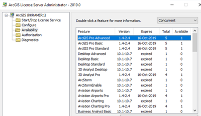

Could you share a screenshot of your License Manager (Availability) like the one below (showing the Defense Mapping and Production Mapping licenses)?
Also share the license status page from ArcGIS Pro as well.
This will give a bit more clarity.
