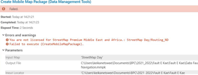

Hello, I am getting an error when I run create Mobile Map Package in ArcGIS Pro. We want to create a Mobile Map Package with our own electric data and consume the Map Package in Navigator. The screenshot below shows the error that we are getting.

Do you have a Streetmap premium layer that you are also publishing as a part of the mobile map package? You would require an ArcGIS Streetmap Premium Extension (for Middle East and Africa, as the error message suggests), to be able to do that.
StreetMap Premium licensing requirements
If you already have the extension, you need to enable the extension.
Note: In the case of ArcGIS StreetMap Premium, map layers that reference StreetMap Premium data will be disabled in the ArcGIS Pro Contents pane unless you have the correct regional StreetMap Premium extension.
Alternatively,you may create a custom network dataset, and use it for routing.

Hi , thank you for the information, currently, we don't have a StreetMap premium extension, we are planning to purchase it and we want to know if this extension is required for each Navigator user or we can just pay for an officer who is using ArcGIS Pro to create custom Mobile Map Package
