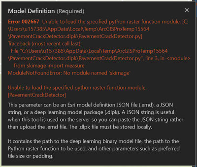

Hello everyone,
I am getting a similar issue as everyone here. I am using ArcGIS Pro version 3.4.2 on a computer with a NVIDIA GPU, created a cloned environment, and installed the tensorflow 2.13.0. I tried installing older versions of this library but they failed to install so I stuck with the compatible version. Here is the error message I am receiving when I use the dlpk file:
I opened the dlpk file to see what line 3 was referring to but line 3 was encoded. Not sure what to try next. Any ideas??
Thank you for your help!
-Joseph
JosephTaylor1
UPDATE:
After I installed the scikit-image library and OpenCV to my cloned environment, the dlpk file no longer has any errors for it to run the tool.
-Joseph
