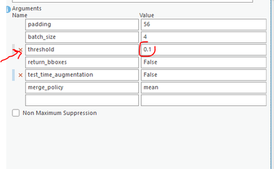

Hi @seisn, I am not sure if it's the quality of the model or something else. You can review the model quality in the model_metrics.html report. As a test, 1. you could try to set your threshold really low e.g. 0.1 and see if there is any output 2. use one of your training samples as in put.
Hope this helps
