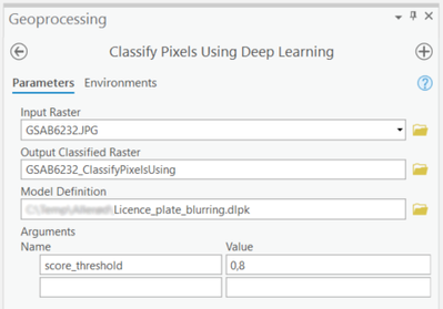

I have a number of photos taken with a GoPro 360 camera, and I want to blur the license plate. Using this package https://www.arcgis.com/home/item.html?id=2ae3cf1af09847a48d65c04b9da6a84f in the tool, I am able to produce new rasters, but the blurred square is not always over the license plate itself. In some cases, the license plate is completely blurred, but in other cases a square over the license plate is blurred. What is going? Am I missing a parameter?

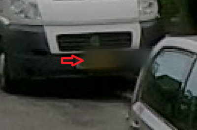

The following photo-snippets are part of a 360 degree photo with three cars in it. The tool successfully blurs the first cars license plate.

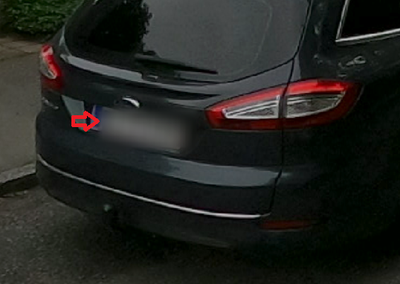

The second car actually blurred the license plate, but as you can see, the blurred square is a little bit off and a lot larger than the license plate itself.

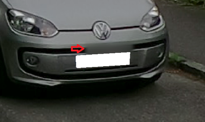

The third cars license plate wasn't blurred at all. Instead the tool blurred a square over the license plate itself.
