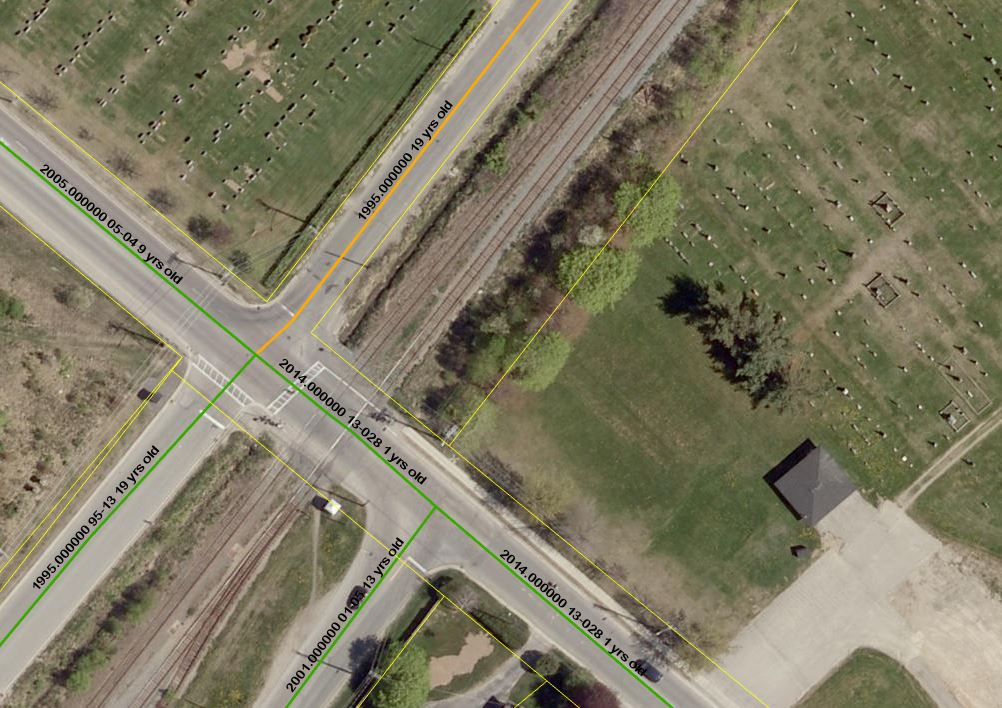

For some reason one of my label expressions [year] is showing 6 decimal places when there should be none.  A similar label [Age] shows properly without any decimal places.  Both field are defined the same as numeric.
Expression:
[Year]&" "& [Project] &" "& [Age]&" yrs old"

BenjaminMittler
As a temporary workaround this should work:
left( [Year] ,4) &" "& [Project] &" "& [Age]&" yrs old"
