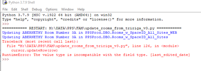

I have a script that automatically updates a sync enabled sde feature class. I populate the last_edited_date field with datetime.now(). This has worked for over a year until last week. All of a sudden I'm getting this error RuntimeError: The value type is incompatible with the field type. [last_edited_date]. Not sure what's going on. The date field in the feature class is in this format: %m/%d/%Y %H:%M%p or 1/28/2021 1:05 PM.
Datetime.now() prints this format: 2021-01-28 13:06:30.180737

So even weirder, the script is actually updating the feature with the current datetime, but I'm still getting that error before the script finishes running:

Finally figured this out. I'm updating two nearly identical datasets, one for the web and one in local projection for printed maps. The local dataset lacks a Global ID field, so the indexs were off by one and the script was trying to put a date in a non-date field. It's strange that this hasn't been an issue before.
