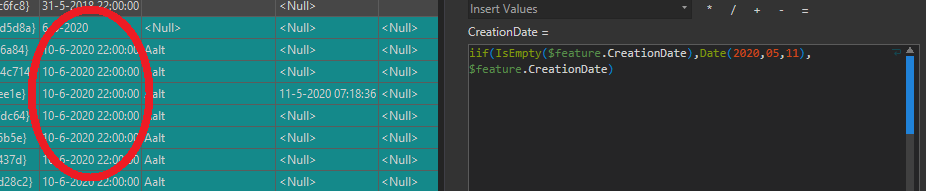

A collegue used collector to record some records but a datefield wasn't filled. I decided to use arcade to fill the field:
But instead of May 11th I see June 10th. This is so confusing.
I understand that date is stored in utc but displayed in my local timezone (I'm near Amsterdam) so I was expecting some hours difference but this seems more than a month.
What am I doing wrong?

When using the Date function, months are defined by 0-11 instead of 1-12.
monthNumberThe month (0-11) where 0 is January and 11 is December.
