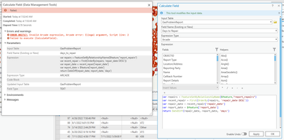

JasonCyphers
I tried... no luck 😞
Script works great in a Portal map pop-up, to display the # of days to repair (I was even able to include some code to display the duration in hours if it was less than a day), so not sure why it won't populate the field in Pro.

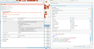

JasonCyphers
Thanks for the help.  That still didn't seem to work though. 🤔
