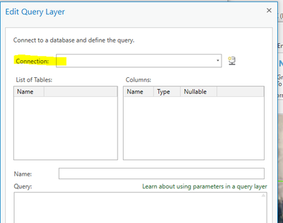

How did you make the connection to your SQLite database in the "Edit Query Layer" dialog?
I don't use SQLite database very often and I can't seem to connect via this dialog to test it.  I know I'm asking more questions than I'm answering, but trying to wrap my head around this.

I just used the Layer Properties > Source > Set Data Source option to select the feature class from my SQLite database, same as I would if connecting to a file geodatabase. And then the Query option is used to choose which fields are selected from the SQLite table.
Edit: Looks like I actually did this through Python, rather than the Arc GUI, using 'lyr.updateConnectionProperties()'.
