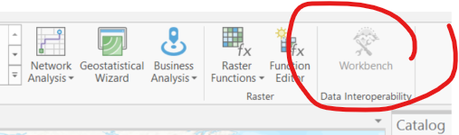

Bruce Harold‌ what is the easiest way to re-install Data Interoperability? I've licensed from ArcGIS Online and it shows as licensed in ArcGIS Pro - but then is greyed out here

I have answered my own question
  1. Go to https://my.esri.com/
  2. My Organizations
  3. Downloads
  4. Product Components
  5. Download Data Interoperability (1GB file!)
  6. Double click the downloadable .exe to extract
  7. Follow prompts
Then as long as you have licensed it (ArcGIS Online Licenses > Organization > Licenses) it should no longer be greyed out. I hope this helps someone out there!

Bruce Harold‌ it might be helpful to add a link to a documentation page on how to download the install when the tool is greyed out for the end user?
