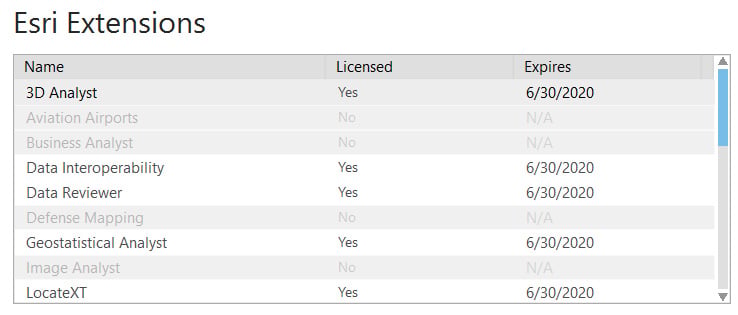

I am running ArcGIS Pro 2.4.1 and have the Data Interoperability extension installed. However, when I try to add a GeoJSON file, it simply is not reading it (doesn't show in the add data dialog box). I also have the Data Interoperability extension for ArcGIS Desktop and I am having no problem reading the same file (I can also read it with QGIS).

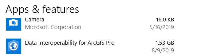

I have uninstalled and re-installed the extension several times, still no avail. I would really like to resolve this issue.
Data Interoperability extension  available
